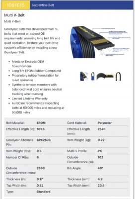

I have always used Goodyear belts and their numbering system is super easy.
2005 Mustang GT 4.6L V8 stock belt is 1061015.
6 rib and 101.5 (102 inches) in length.
So if you needed a shorter belt… for example 1060985 that would be the same belt but 98.5 inches.
I hope this helps.
I hope this helps.
I should have mentioned in the initial post, the car has a Kenne Bell supercharger, so the belt is considerably longer than factory. Thank you, though
