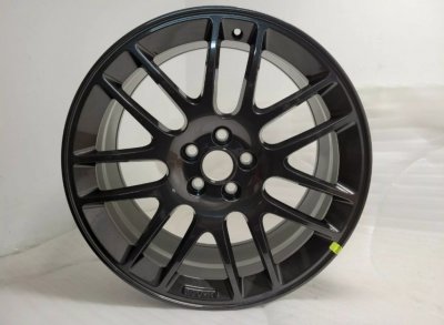

I have a 2014 GT with factory Brembos and I am looking at a set of Roush wheels that are a good price.
Roush 20x9.5 wheels, 45mm offset, plan on running 255's up front.
The big issue is that myself and my car are currently overseas and pulling the trigger on this could result very costly if they dont fit.
I just need some guidance in letting me know if they will fit or not. Thanks in advance!

They look like they would have fairly generous caliper clearance but they were were designed for use on the Roush S550s so there's no guarantee they'll clear the S197 Brembos. Are they cheap enough that you could re-sell them without taking a big hit if they don't fit?

They are a great price, but, like I said, I am overseas. So once I pay the hefty shipping to get them out here...thats pretty much it. If I were in the States I would risk it, but unfortunately its too big of a risk. That is why I came here for wisdom.
