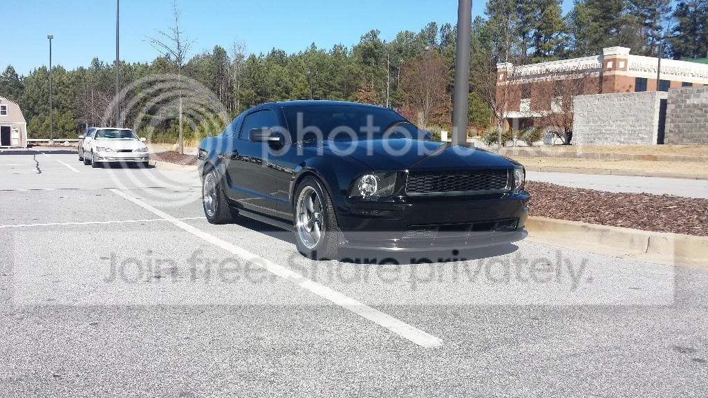

28.2" on the fronts will look goofy IMO, that's a lot of side wall, your handling could suffer was well IMO

I already have 28.2"(235/55/18) all around. It's just the wheels I bought used came with 2 tires and they're a crappy unknown brand so after 7 months of dealing with them, I'm getting rid of them. Horrible understeer when they were on the front, and now I have limited traction with them on the rear
Just can't decide what size I wanna go with out of the few options
+ 2. I'm close to a 27 up front and a 28 in the back. Do whatever you gotta do to get ride of the 28.2 up front.

Sidewall isn't too bad but it's definitely there
I think I'm just buy 4 new tires, probably like a 255/45, maybe a 265 if it's within specs. I would love to buy some 18x10 wheels all around but that's not in the budget till next year
