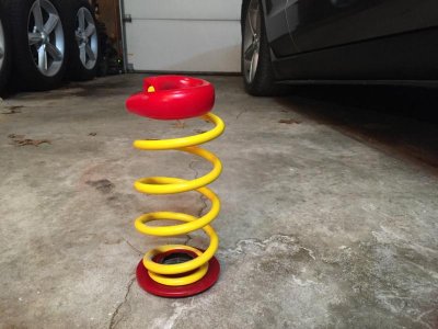

This is the only photo I have. These isolators were much thicker than the stock ones.
Gabe
Whippled Coyote
Aug 7, 2011
8,470
1,563
Cool, thank you.
Enegry Suspension lists that part number as a 1/4" thick spacer
