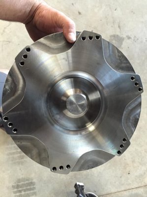

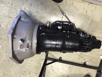

Turbo 400 and stall just sitting waiting on the engine
The new turbos will be here early next week upgraded to the Gen 2s 6765. The shortblock is assembled ready to roll.
