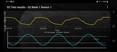

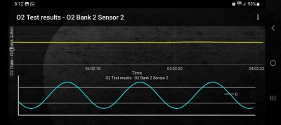

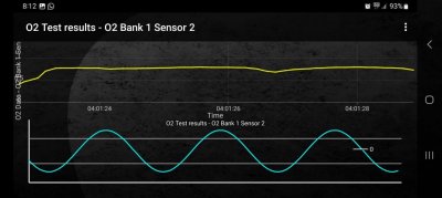

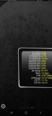

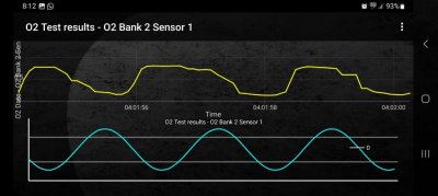

I have strange issue keep appearing since i replaced my ECU/ PCM from junk yeard. i have like these codes keep appearing. all of them at once P0053 P0054 P0059 P0060. (attached)
I thought Ok! maybe its the O2 sensor is dead and so i changed them all ( all 4 upstream and downstream). still the issue appearing after like 2 days or 3. then i replaced only one thinking maybe the guy who installed them messed them up somehow. still the codes come back! not one or 2 but all of them.
I can see there is volts/ signal on them according to the ODBII just like before i replaced them and the device showing they are active and running fine. also wires are ok.(attached)

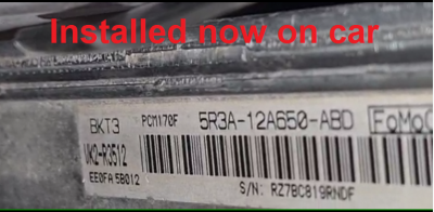

Hi all :)
here is the one I have previously and the one installed now. i dont have the very old one (Yes this is the 2nd time it got replaced). i can see many codes are same even tho am not good with what it mean these lines on the stickers.
what you guys think? a tune might correct this one? i have seen bad tuning happen for many guys that tried to tune it for different Octane and only when they return it stock it fixed it. i have couple of signs that the current PCM was tuned before (Idle RPM high, Fan kick early..).

Forget the tune. It needs to be flashed by the dealer so the vehicle recognizes the new PCM. Once that is corrected you can worry about a tune.
