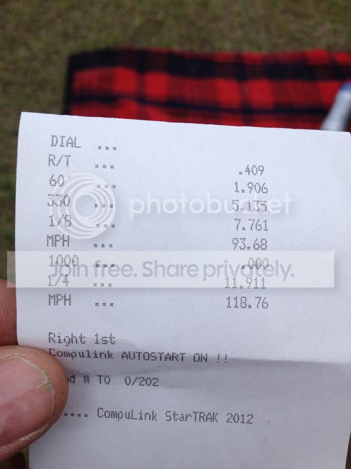

Mods are:
Boss IM, Airaid CAI, Pypes LT and Off Road X, Shaftmasters DS, BMR Sway Bar Delete. 275/50/15 MT Drag Radials.
Stock cat back exhaust. Stock suspension.
Circle D 5C going in this week.
DA was 1350. Corrected ET would be 11.73 @ 120 mph using the Drag Times calculator

Congrats... im surprised it runs that well with the stock converter and boss combo.
What is it shifting at?
I bet you pick up at least .5 from the converter.

Thanks man. I was pleasantly surprised as well. Shifting at 7500-7600
That's my thinking as well, .4-.5 seems to be about what most gain.
I'll do some suspension work to the rear once I go back to the track with the convertor.
