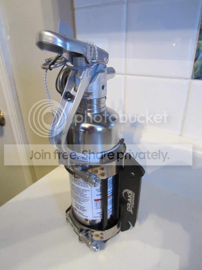

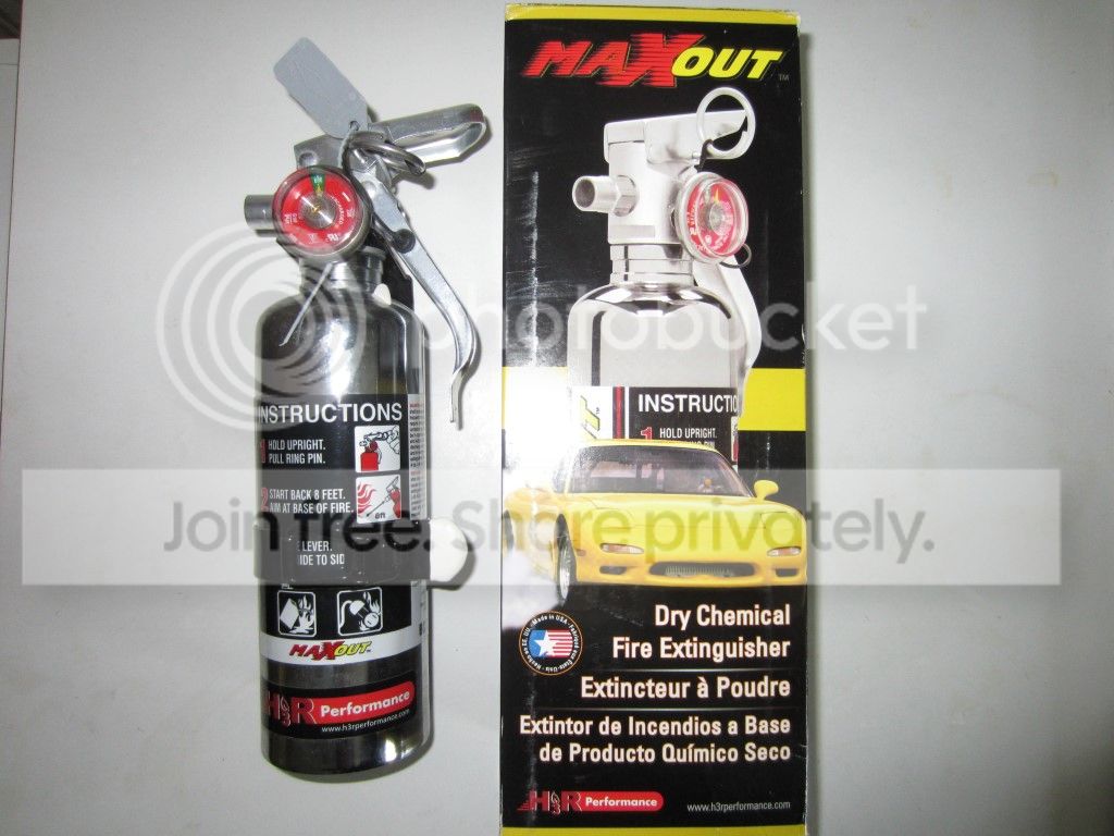

Picked up a H3R Performance MaXout dry chemical fire extinguisher model number MAX100C and Scott Drake fire extinguisher mounting brackets. My car has an electric seat on the passenger side so the correct seat bracket was part number 5R3Z-FIREX-ELEC to mate with the quick release mount, part number FIREX-MNT=DAG.

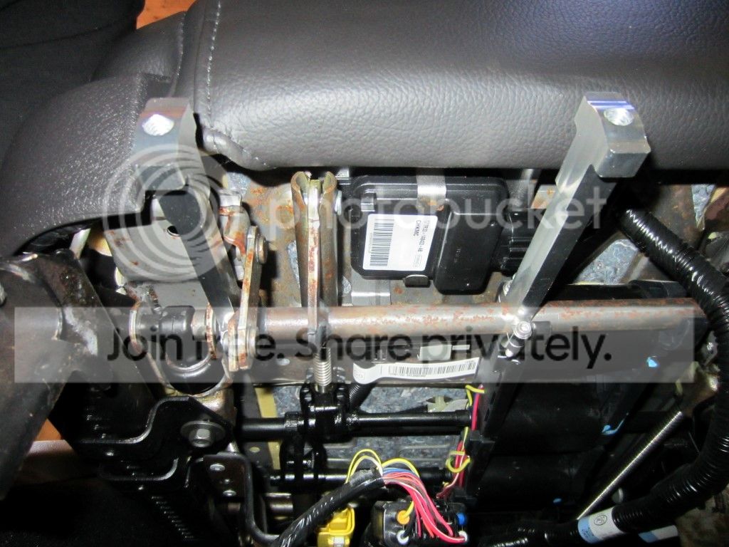

Someone with skinny fingers may be able to install the seat mount without unbolting the seat, but not me. Rear seat bolt floor covers were slid off and the rear nuts removed with a 15mm socket. Seat was slide back and the front bolts removed with a 13mm socket. I used a piece of 4 x 4 to hold the seat up while installing the electric seat mounts. Not sure if the small Allen head cap screws were metric or SAE but a 3mm Allen wrench seemed to do the trick.
Fire extinguisher mount was fastened to the seat brackets with a 3/16 Allen socket.
Using a 7/16” ratchet wrench the fire extinguisher was hastened to the removable section of the quick release mount with a pair of 2.56” - 2.8” (65mm – 73mm) T-Bolt Clamps.
Front seat bolts and rear seat nuts were installed and rear track covers slipped on. Fire extinguisher was fastened to the quick release mount.

How was the mounting hardware. I've read that its not the correct length.
Scott Drake makes hardware for both power seats and manual seats. I used the power set version and in my opinion the length is perfect.
A friend of mine has the manual seat mount on his Shelby. He had to have the mount holes machined as the holes were too small for the seat bar.
That's what I read. My pass seat is also manual so I'll measure it and have it machined before I even try installing it.
