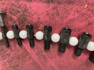

Problem was solved, I didnt find the correct screws for the MAF but I installed a couple 8-32 nut inserts for a total of $3.79 and called it a day. So now my stock airbox and Roush use the same hardware for the MAF.
got the stock tune back in and its running good.
