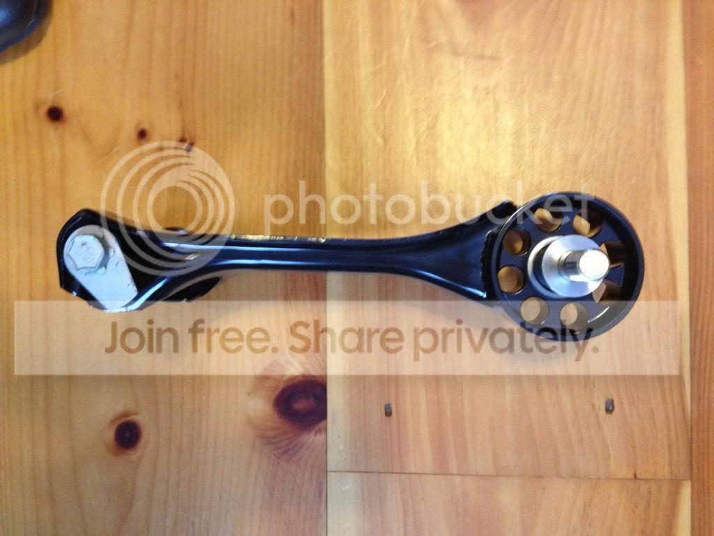

Has anyone had a chance to find the UCA that is supposedly used on the Boss 302 cars with the spherical bearing where the rubber is? Does anyone know a price?
Greg Hazlett
Stepping on the Pink Bus
Official Vendor
Nov 2, 2009
23,977
336
Chesapeake, VA
Ask Jayman33; he has a Boss but not sure if he changed out the UCA.
BMR Tech
Traction Vendor
Official Vendor
Dec 15, 2009
4,863
11
Tampa, FL
There is one on the R/S cars that is made by Multimatic. I believe it is priced in the $600 range, though. I think you can only order it directly through them.
I'd recommend going with something like our UTCA020, though....for less than half the price. It is a bearing and is adjustable.
Actually, I would recommend a poly/adjustable UCA with a bearing in the diff...
Here is the Boss 302 R/S UCA.
