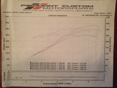

This motor I Dyno’d after doing various bolt-ons until there was nothing left to do.
Then I bolted a 2014 Gt500 tvs supercharger on it and make 610 rwhp.
Wish I’d have skipped all the bolt ons except the cams and just went straight to the supercharger
@ESP41 BaddGT is right.
His NA build was awesome with a torque curve to be proud of. However if you tried to replicate it today, the collective cost of CNC ported heads plus SPR cams, phaser limiters, new phaser bolts, and head changing kit would be ~$4000. He kept the stock intake manifold with CMCV delete but if you wanted to bolt on the Ford Performance intake manifold with 62mm throttle body, that would add another ~$1300. Don't forget the CAI, underdrive pulleys, LT headers, and tune that are also required to get to ~380rwhp. A supercharger or turbo kit would give you far more bang for practically the same buck.
At this point you might be even more tempted to do a Coyote swap but ask yourself this. Would you be happy to spend over $10k and settle for "only" ~420rwhp, or would you be looking for a further $10k to boost the Coyote 'cause the itch would be too intense not to scratch?
