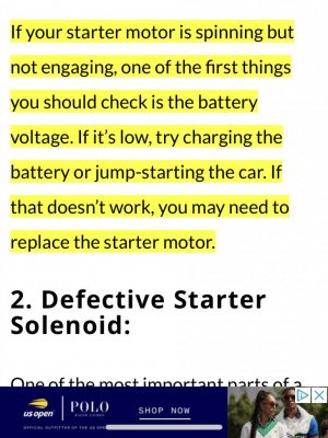

Maybe I'm just not understanding. But it seems like if the starter is spinning nut not engaging, wouldn't that be a starter issue as opposed to a low battery or bad connection? I'm just saying as many bad/low batteries I have had I can't ever remember the starter not engaging the flywheel. I've had bad or poorly mounted starters act that way but never a battery issue.
See line 5 of first post.
