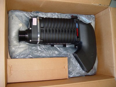

Not sure if this is the right place for this. I have a 2008 GT500 with 2.9 Whipple. I have a Cobra Jet TB on it. Is anyone running that one and are you having any issues with it?
