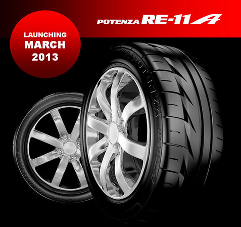

I'm a fan of the RE-11, personally, and have had good luck with them in STU autocrossing as well as on track. But they are a bit pricy. The RE-11A is too new but I'm hearing promising things from my friends at Bridgestone.

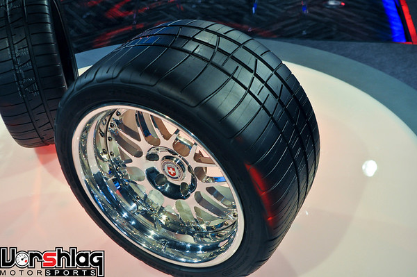

The BFG is incredible, as I've written about in my Vorshlag Review of the BFGoodrich Rival. They said they will not make a 19" size for at least a year, though.

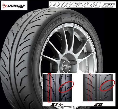

Dunlop ZII was actually tested at this BFG Rival test, and it did "OK" but was a second slower per lap, on a road course. Probably closer than anything else we tested that week (Hankook RS-3, Toyo R1R, Falken 615K).

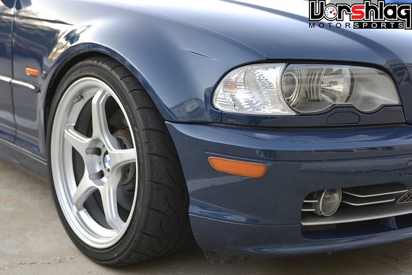

Don't rule out the Yokohama AD-08. We have had great luck with those in SCCA Solo use in STU class, for one. The price might be uncomfortable though - gotta check that, and available sizes.

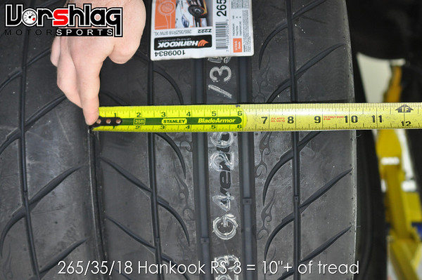

The Hankook RS-3 is worth looking at, of course. We had pretty good luck with these in multiple sizes when we ran STX in our 2011 GT. They have two 265mm 18" sizes, but I don't know about the 19" stuff.

The ZII is prone to getting too hot. We've seen it in testing here, and even Dunlop's own information on their website showed that over the course of laps the jump the ZII's had on Z1's shrunk until by the end of 10 laps the Z1's had basically caught up.
