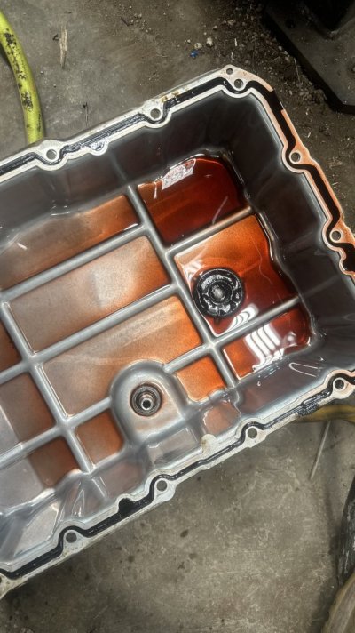

I put new solenoid in and new filter and flushed first gear works great but everything else is gone it started doing it slowly acting up not bad just not going to 4th then got it home fine then went to leave again and nothing except 1st gear
