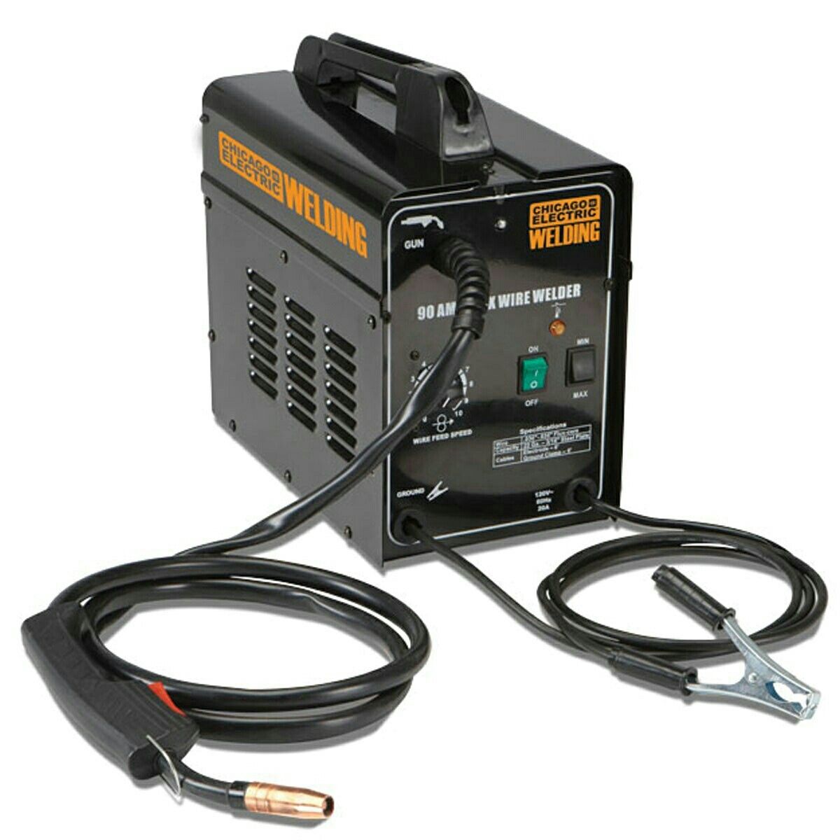

Yeah, I guess the question is why? I have seen Mustangs go low-9's on 10" tires, so what is he trying to accomplish? Is it an old school Pro Street look with a narrowed rearend and 6-71 sticking out of the hood?
Either way, he doesn't seem to have the KSA's to pull this modification off... so off to a chassis engineering shop for a quote. FYI I don't know how to do this either, so I too would farm it out to a local reputable shop.
