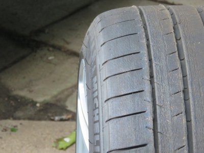

What do you consider "completely stretched"? Here's what 285/35 on maximum-recommended 11" wide rims looks like (they're 18's, but wheel diameter does not affect the sidewall shape/amount of bulge or stretch).

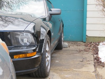

Tires on "measuring width" rims have a little more sidewall "shape". Here's what 265/40's look like on 9.5" rims.
