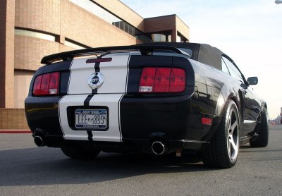

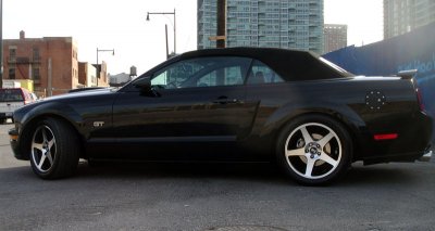

I have 18 x 9 26mm offset wheels with 275-40's all around, im lowered with 1" F & 1.25" Steeda Sport springs, ive taken the car Autocross racing many times since i put these wheels on and i have ZERO rubbing issues. I think it looks really bad ass and i get great reactions from people at shows but the look is not for everyone.
24mm with a 305 may pushing it though but i guess you can have your fender rolled if your set on using that width in the rear.
