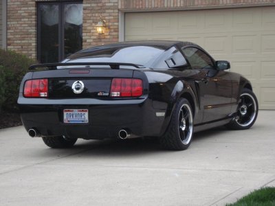

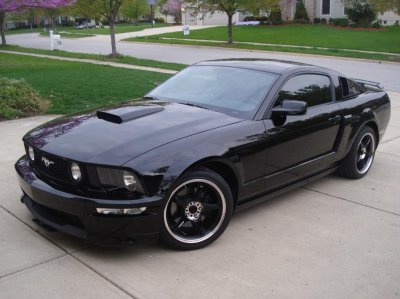

Hi Steve -
Did you actually put those wheels over a S197 14" brake kit?
The reason I ask is that I have gone round and round with Brembo and Wilwood, and according to their measurements and templates - it aint happening.
I run the R58's on both of my cars, since I use the same offset on my Fox and my S197.
yes and no, I run a gt40 brembo caliper and bracket and a stoptech 355 rotor. not gt500 brakes so I can't tell if they work on that .never tried though. I had to grind the very top of the caliper a little to get them to fit but they do...Yes, if you look at a paper with proper wheel fitment then it will not work.
