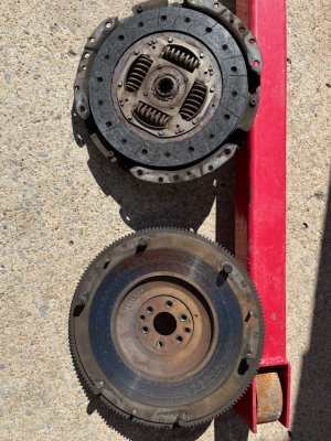

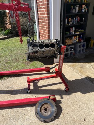

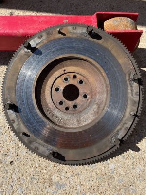

Figure I’ll put new motor and tranny mounts on it….stock the way to go? I’ve looked at the Prothane Urethane mounts but have also seem people say they allow a lot of movement from motor & tranny that you feel in the car. Got the motor out yest, trannys coming out today with rest of evap crap. Found pieces of the timing chain guides in pickup and oil pan
