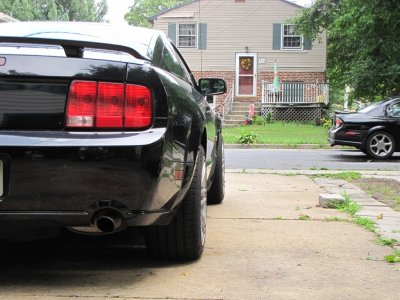

Pictured below is a 285/35-18 tire on an 18 x 11 wheel but no lowering. Half an inch lower on fairly stiff lowering springs still worked without rubbing but I can't vouch for any more lowering than that. Clearances to the strut are as tight as possible without rubbing and I am running about -2° camber, so that's about the smallest amount of poke possible with 11" wheels up front.

285/35-18 on 18x11, mid +50's offset. 285/30-19 on 11" with offset in the low to mid +50 range would look similar. Car is not lowered in this picture but has run with about 5/8" lowering without rubbing even in a road course setting. PHB has had its bushings stiffened (not replaced) but is otherwise OE.
