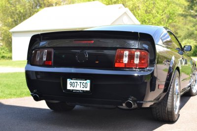

I'm running 18x10's on the rear with 295-45 Nitto 555 with Rousch rear springs dropped 1.5 inches and have no clearance issues and do not stick out past fender. But offset is stock +45mm. Here is pic of the rear of my car.
