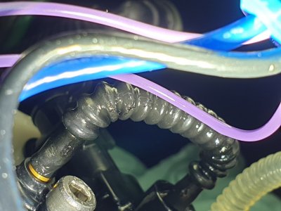

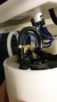

I use HP-TUNERS but I have partially solved the problem, a hose on the intank pump was broken.
then installed a new one.
