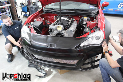

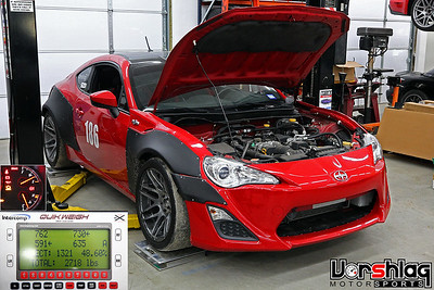

We have installed Duraflex products - and we are a dealer for Duraflex / Carbon Creations / Extreme Dimensions (all are part of the same company). Just know that these products are definitely made in China and the quality is reflected by their price.
Of the six items we have purchased form them over the years, two were unusable, two were pretty rough (including the flares on the 86), and two were actually good (including the carbon nose on the 86 above).
Now we have had much better luck with Seibon / Anderson Composites parts. We have used a number of their composite hoods, trunks, and even fenders and have always been impressed with the quality. They make a number of hoods for the S197. We're a dealer for these parts as well.
