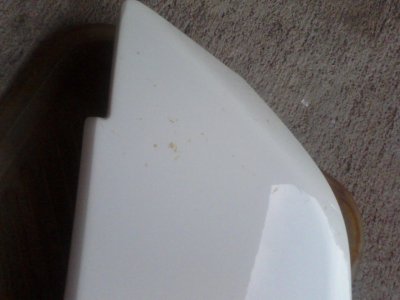

I'm resurrecting this one. I bought a GT500 spoiler from someone on another site, and it came with a little extra coloring. I think that it is sap.
I've tried goo-gone & purell, and that took off the surface stuff. Now it seems like what is left is cut into the clear coat.
Is wet-sanding my only option?

For relatively fresh sap, rubbing alcohol works great. I used it on the black GN
many times, when I was dumb enough to park under a tree. It is easy to do, just
wet a cloth and rub gently, then re-wax that section. And it's CHEAP !

I wouldn't use alcohol on paint. anything over 70 proof will melt your clear right off.
Goo gone can work, I would remove most of it with water and soap , then CLAYBAR time. That sucker removed all.
