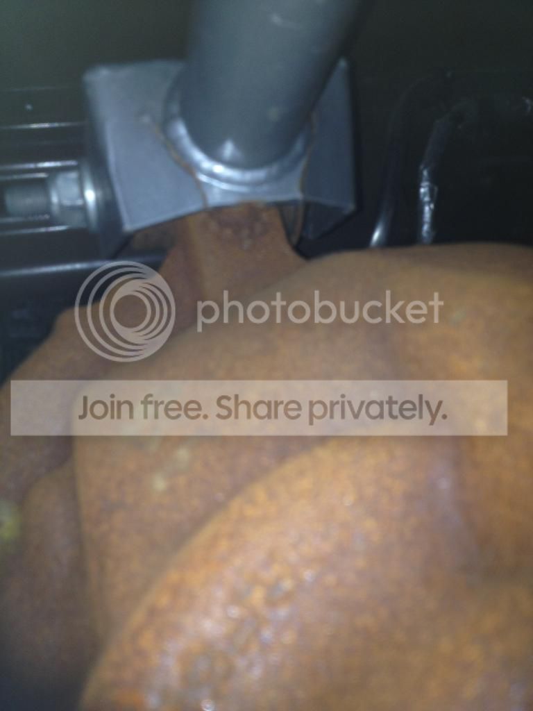

Hey guys check your Whiteline uppers. Looks like their uppers are having some issues as pictured above.
Just make sure for safety reasons you hop under your car and check it out.

It looks like they forgot a spacer or washer. Look at how the bracket is bent from the bolt being tightned. Right where its cracked its "U" shaped. I bet money it was installed wrong! :wtf1:

There are no spacers or washers to install. What's in the picture is what happens when the material used is simply too thin, and is pulled/stretched in that way.

I read some of the posts on the SVT site and apparently its isolated to only a few cars. Definitely need to look to see but their are a lot that has been sold and Whiteline is standing behind the parts and are doing something about it. They may have been sent the wrong material. It happens here sometimes. Maybe Terry can chime in. I know they have been using theirs and have had no problems from his posts.
:wtf1:
I know you are a large supporter of WL, but, come-on.
1/8" material on one of the hardest hit parts under the car.....

OH I AGREE 100% something is wrong! But to sit here and say that everything about them sucks is wrong. Look at your A-arms. Their have been failures yes but you stood behind your product and you are fixing the problem. According to Whiteline they are standing up and addressing the problem. Will we know the exact root cause of the problem (thin metal, wrong material etc) probably not. But if they stand up, address the problem and get it fixed and take care of the customer then it will be good. You guys had failures also and you addressed the problem, got it fixed and took care of the customers and everything was good to go. Just because you have some isolated failures does not mean an entire suspension line is junk. :thumb:

Whiteline stopped sales of the UCA for the time being. Eric, who's car is this?
I'm wondering if there was a bad batch? Don't get me wrong the walls are thin but there are a few 600 plus HP cars that have been running this for quite some time.
Good thing WL is taking care of this problem.
Come on... do at least a cursory look at the issue before "bet[ting] money it was installed wrong." Good thing Whiteline didn't immediately jump to blaming the customer.

This is where you realize there was no engineer involved in the design.
I wonder what kind of product testing they do? Aftermarket suspension companies must not be subject to ntsb oversite. As ridiculous as it sounds a suspension failure could be catastrophic to anyone on the road.

Their is no agenda and I'm really not sure what your problem is but you new to take a breath and calm down. Im not a dealer or geting any freebies from them. If you go to the SVT site and read thru everything they are saying yes a lot of them are saying the complete line sucks. He did not. I was generalizing. I have not installed mine as of yet nore have I read the instructions until today. The pic looks like the bracket was squeezed together by the pic until you go and read the description on the other site. With that being said with just a couple units doing this I think Whiteline I going above and beyond trying to fix it just like BMR did with their a-arms. Look at Terry, he pushes his car every weekend and has never said anything about a failure. Just like the guy just below your post saying its a weak ass part. 5 parts out of thousands makes it weak ass? Let them figure out what happned and lets see what they do about it before we flame the shit out of them.

"That guy" still thinks it looks weak. I don't care how you want smooth it over. I will wait to see the results though before making a judgment.

I'm with you I want to know why it failed. Just because it looks week does not mean it is. We don't know what research they did before they made it, testing, heat treating etc. I will be intrested to see what actually is the root cause of just 5 units failing out of thousands they have sold.

I agree, it takes a lot of effort to jump on and attempt to rectify a situation like they have, it is surely good to see companies take that step.
As for the testing, and the cars running these parts, I guess it just depends on the fine details. Has there been an issue that was hidden, or not mentioned? Are/have the people with these cars actually inspected their components? Not sure if you are seeing the threads on SVTP, but, 5+ people in a single thread is, well, overwhelming.
We had an A-Arm incident with someone, who admitted to me on the phone that he had never one time inspected the parts after the years of abuse he put them through. When we analyzed the piece, we discovered that the gusset on the A-Arm had been cracked for a substantial period of time, we estimate 1-2 years. We have felt the pain that WL is feeling, and I truly hope they get everything squared away for their customers, and release a new UCA system that performs flawlessly. Heck, they should just duplicate our UCA differential side mount, and they will be good to go! ;)

First of all, I have never stated their entire line is junk. I recommended their Wats Link to a customer last week.:thumb:
Thousands? They (WL) claimed "100's" on another thread.
Regardless, 5+ people in a single thread is proof that there is an issue, no matter which way you spin it.
That thread on SVTP was made, and it appears that almost every user in that thread checked their WL UCA, and it was defective.
The above in bold is exactly why some companies are making these threads.
