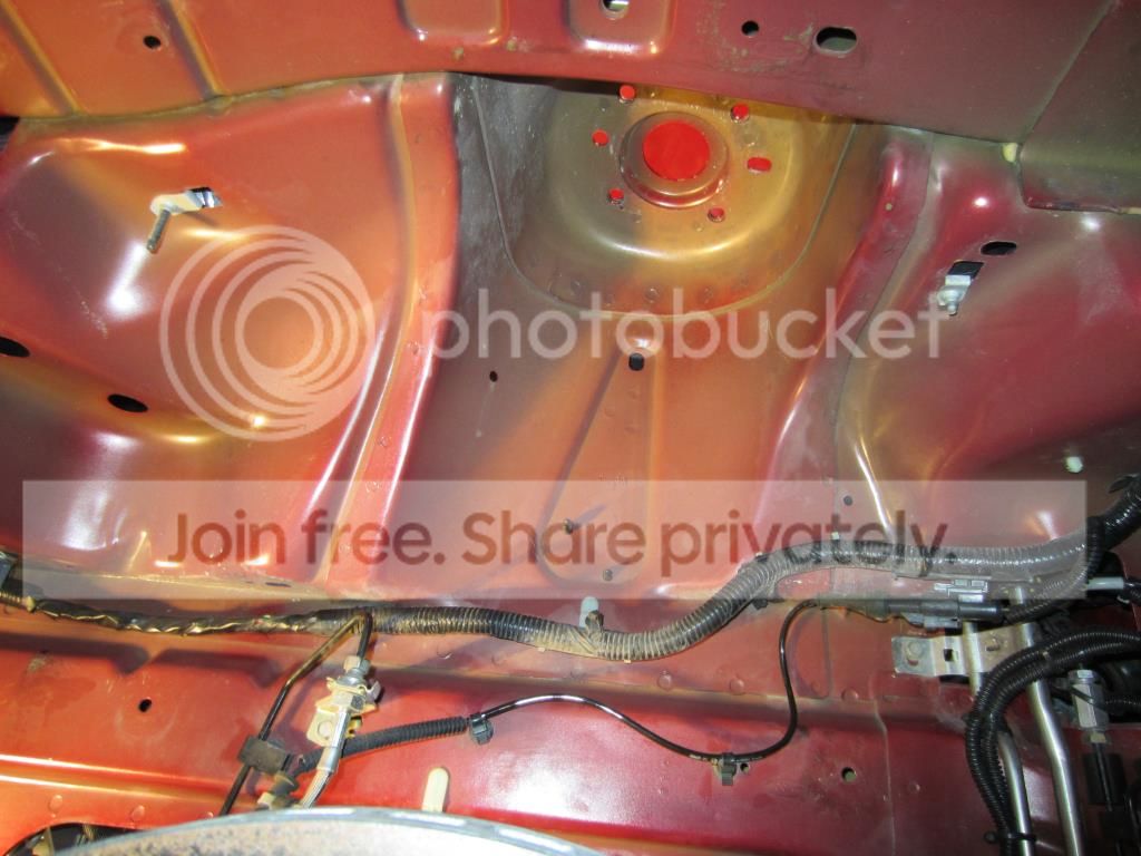

I plan on putting the compressor, tank and manifold in the trunk tire well. The 4 gallon aluminum tank with the kit at 30” long is just too long to fit so I am going to follow GallopingFord (Cam’s) lead as I have a 20” long 2.5 gallon aluminum tank on order.
While most of the rear install is out of the question until I can get under the car, I see no reason why I can’t tackle the front struts and start running the air lines, and doing the electrical. My battery is in the trunk so the only cable into the interior will be for the AutoPilot V2 Digital Controller.

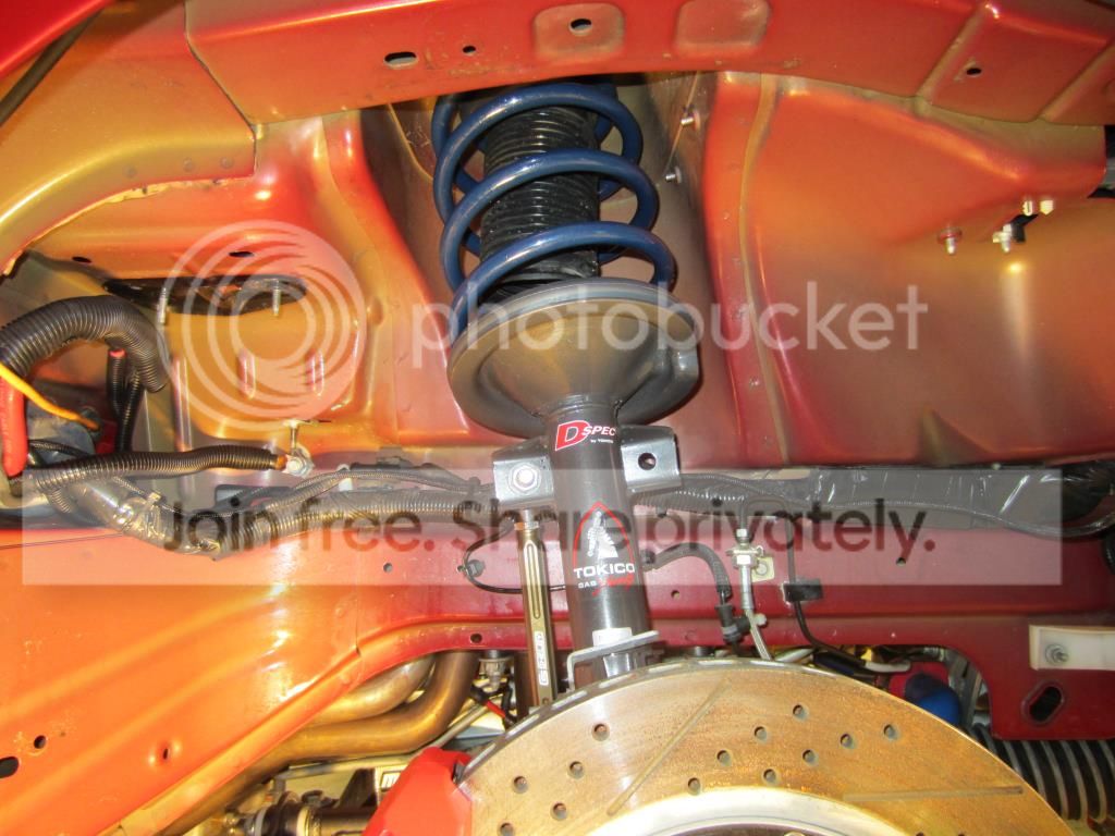

I tackled removing the passenger side strut today. Started by removing both inner fender splash shields.
Removed the end link nut and the spindle bolts with an 18mm socket.

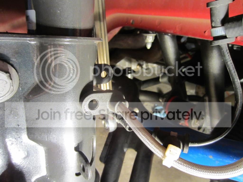

Removed the brake line bolt with a 10mm socket.

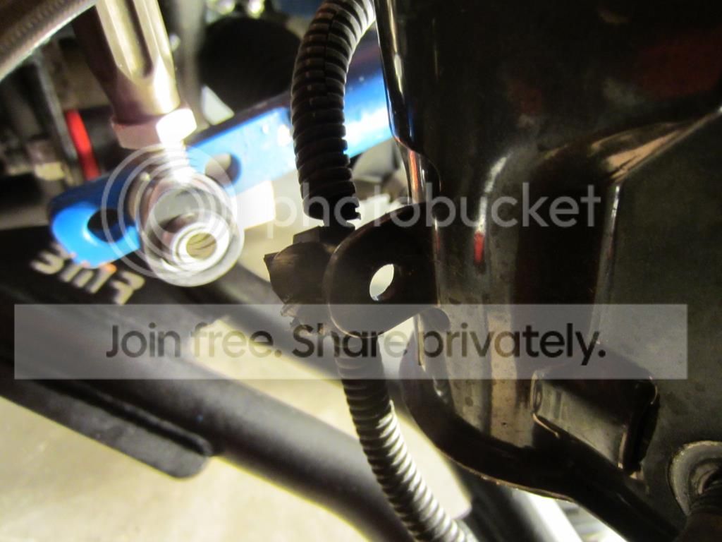

Released the ABS cable with the flat blade screwdriver.

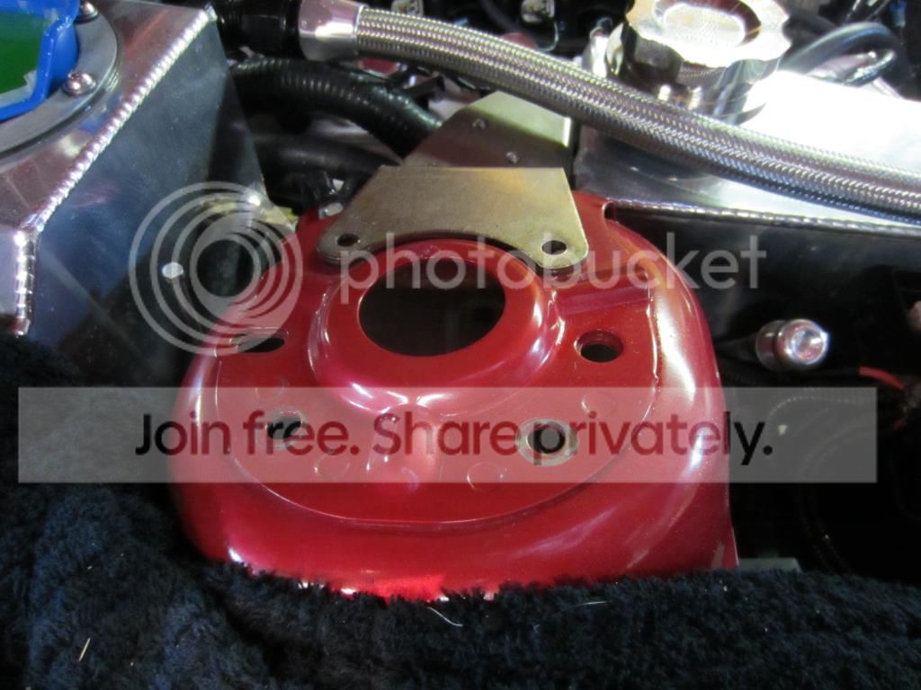

Removed the upper strut mount nuts with a 13mm socket and the Maximum Motorsport Caster Camber Plate nut with a 17mm socket.
Supported the hub assembly with a block of wood and a floor jack and removed the strut from the car.

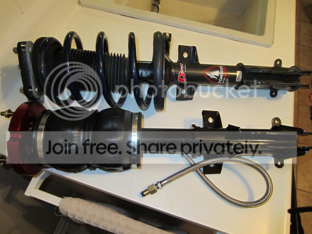

Opened the box for the front struts, kit 75523.

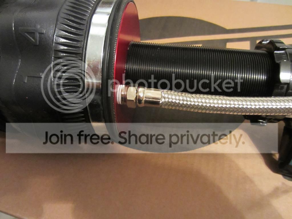

Prepared the strut air leads with Teflon tape on each end and threaded one end into the strut assembly and the other end into the fitting. Both ends were turned 1 – ¾” turns after hand tight with 11/16 and 15mm wrenches.
Air line end.
Strut end.
And the obligatory old versus the new. The new struts are significantly lighter than the Tokico Dspecs, Steeda Sport Springs and Maximum Motorsport Caster Camber Plates.

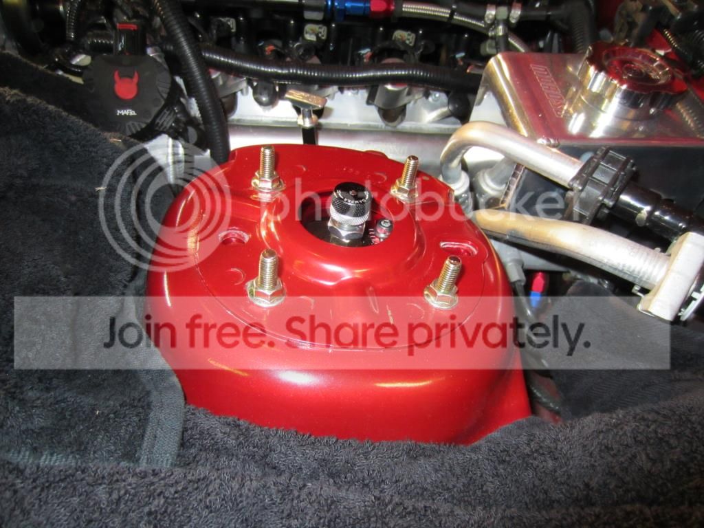

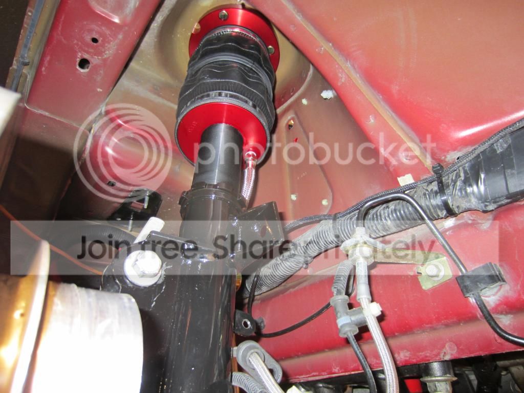

Much colder in the garage today and lots of snow outside! Got both struts installed, but everything still needs to be torqued to specifications.

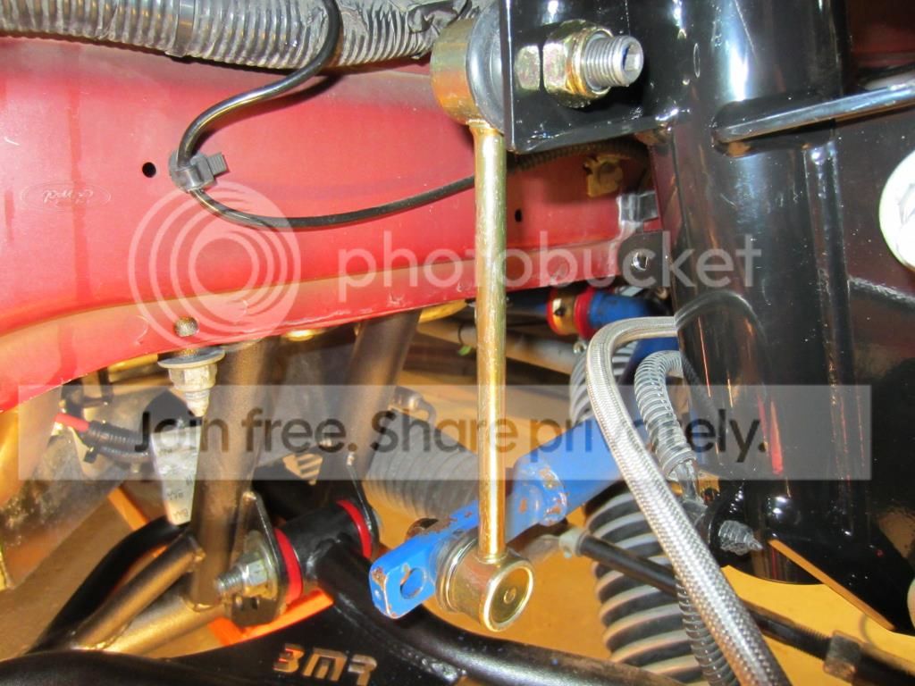

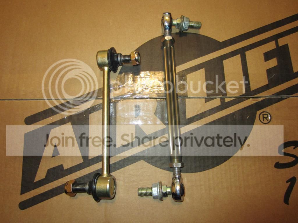

The End Links provided in the kit are significantly shorter than my Shelby Performance Parts Links that are OEM length.
New strut is right at home on the passenger’s side. Torque specifications for the strut to wheel spindle bolts is 148 ft-lbs with an 18mm socket.
Air Lift install instruction call for a 46 ft-lbs torque on the top nuts. Doesn’t seem right to me and I am trying to confirm. OEM nuts are only tightened to 26 ft-lbs with a 13mm socket.
ABS clip pushed back on.
Brake line attached and torqued to 15 ft-lbs with a 10mm socket.
Air Lift 185mm End Link tightened up using a 6mm Allen socket and 19mm wrench. Torque specification for the end links is 85 ft-lbs.

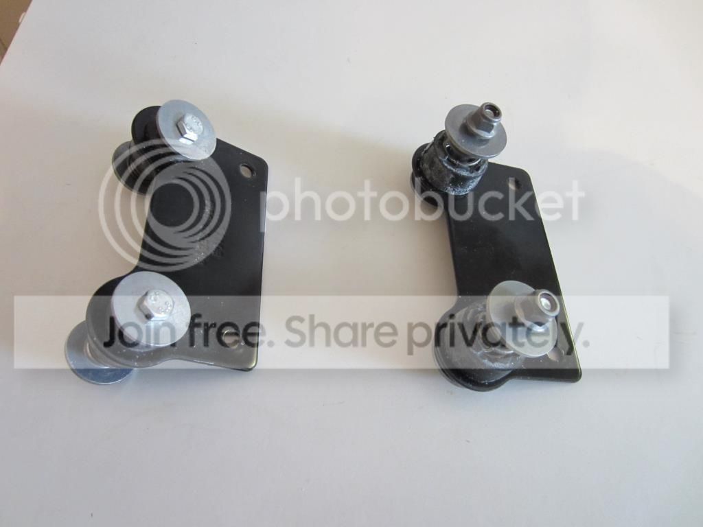

The Compressor Isolator Kit is optional and designed with a combination of rubber and spring mounting to minimize the vibration transferred to the car. If my installation goes as planned the compressor will be mounted on ½” plywood in the tire well. It looks like it is going to be very close if the provided M6 x 45 mounting bolts will be long enough to work with the plywood.
Compressor Isolator Kit assembled, top view on the left and bottom view on the right.

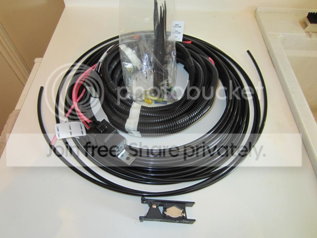

Electrical Harness, 60' of ¼” Air Line, Air Line Cutter, Wire Ties, Fuses, Fuse Holders, Connectors and Mounting Screws for the Manifold and Replay.
