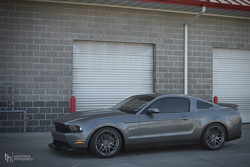

A few photos and a video from my second ever trip around the "track"
#FEF by t.hockman photography, on Flickr
World Challenge Splitter 2 | Crop by t.hockman photography, on Flickr
