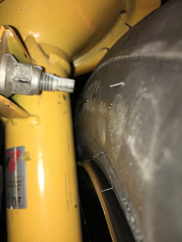

Using an 8MM hub centric spacer in the front. The wheels fit with no spacer, but clearance from the offset strut, was unacceptable. A 5MM spacer left plenty of clearance, but we opted for a little more spacer
Leaving out the matters of scrub radius and brake ducts for a moment, just how much clearance do you need in order to consider it 'acceptable'? Serious question.

Is that tire actually inflated in that picture or do those tires run that narrow? It looks like I'm seeing way too much flange here, all the way onto the inside face.
FWIW, that's a ton of room compared to my own fully streetable track day setup (18x11 F14's with 285/35 PSS, Koni yellows, no spacer, just not rotatable front to rear).
Norm
3MM or so of space would be acceptable for me. I know it can be very close. We had more than that with the 5MM spacer but lock to lock resulted in clearance issues with brake cooling ducts.
The tire is fully inflated. NT01 tires don't have a rim protector on them. Which is why they look the way they do. In the pictures it makes it look like there is extra flange on the rim but there isn't. No rim protector means no extra rubber to go over the flange of the rim.
