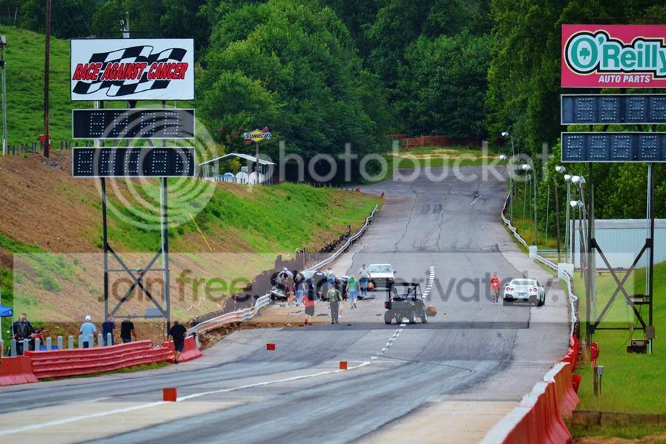

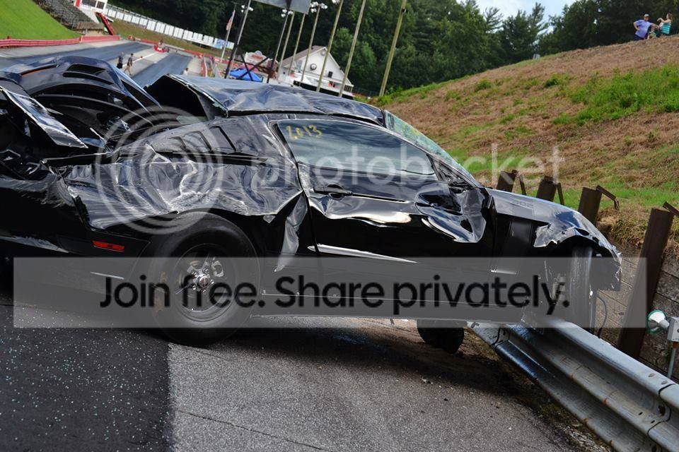

I'm going to go one step further on the diagnosis of this picture and lay my head on the chopping block by claiming that the terrible welding is most likely the cause of the failure. On the axle tube as it comes from the factory, there is no inherent weak spot right where the pumpkin sleeves end. The tubes slip through and are pinned inside the sleeves. I think that not only did the welder not get penetration on the pumpkin with his crappy weld, but he also overheated the tubes creating a weak spot right where he was attempting to reinforce them. The break was right along the edge of his shitty weld and therefore I think having the axles welded improperly (as the images above show) does much more harm than good. I'm not 100% certain but my assumption is that the axle tube may not have failed at that point if it had not been weakened by the heat from the welder.
19COBRA93
Ford Racing
Dec 17, 2008
7,577
20
Clinton, Ut
The pictures BMR added on Facebook actually reinforce my theory that the failure wasn't from a twisted axle tube.
Especially because of the hard impact on the wheel on the LH side, and the skid marks from the RH tire (sorry Kelly, I stole these pics):
