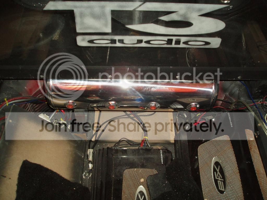

Well polished air tank arrived today , I did a test fit for both the air tank and air compressor,should be no problem,I'm going to run my air filter for the compressor to a different location. this air tank weighs only 5 lbs. But I'll have to get a longer air leader line because of compressor location.
compressor test fit location
tank location

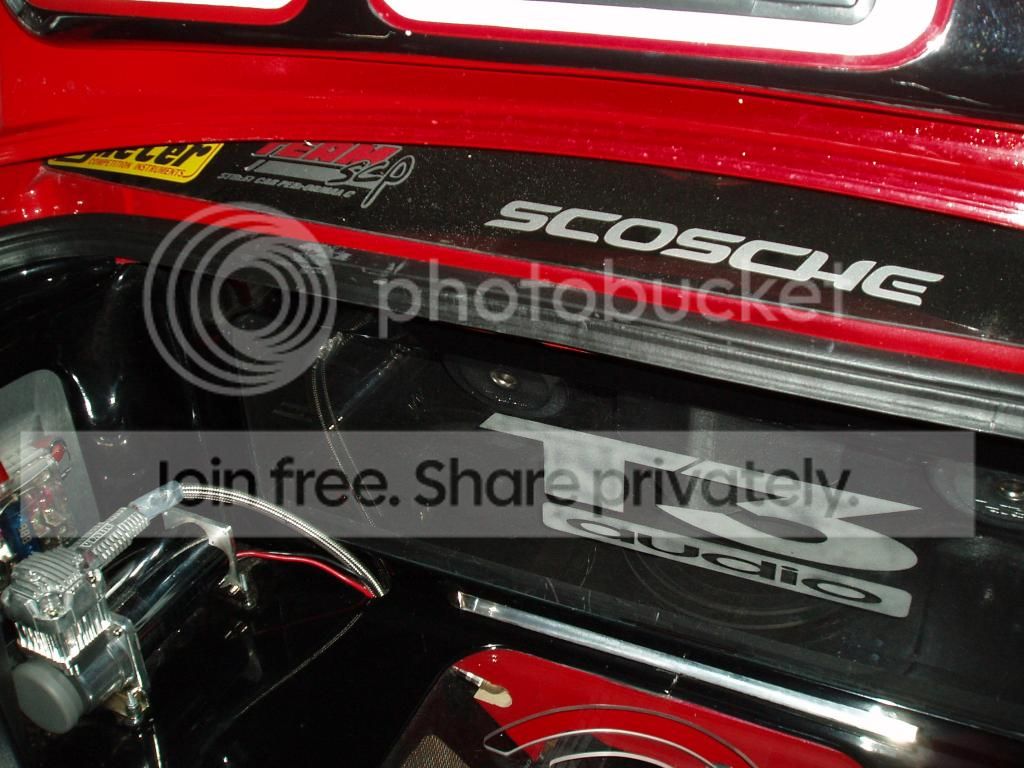

Well after a test fit of the amp cover over the air tank,I figured I'd place air compressor on top of it and I think after looking at it, I'm going to mount the air compressors on each side like in the picture.
test fit, rear cover that's around the sub is off in this picture

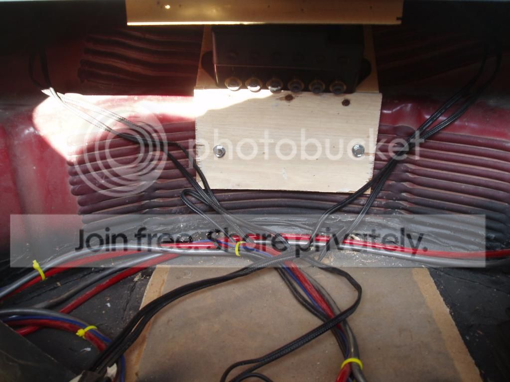

well worked on the car a little bit on Saturday, mounted the air lines manifold. made a mounting bracket out of wood,it was either wood or aluminum , but I didn't have any aluminum laying around. I hope to finish the the air ride project this coming week.

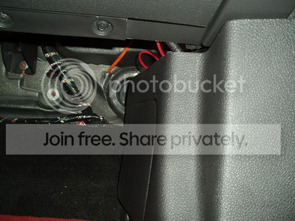

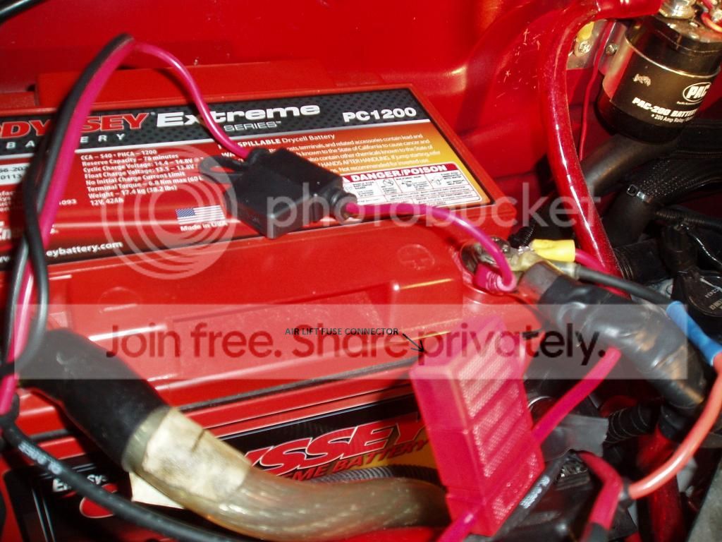

More progress pictures, After the 18AWG pink wire from the Air Lift harness was extracted from the wire loom and routed to the driver’s side FPDM and tapped to the white wire on the FPDM harness,I then routed the Air Lift wire loom along with the air line from the trunk area to the passenger side through the firewall out to the battery compartment.
I then wire tied both the passenger front air line to the strut and Air Lift wire loom as I then proceeded to remove the battery and battery tray to rout the loom to battery compartment. Since replacement battery is smaller than the original battery,I drilled a small hole to run the loom through for connection of the Air Lift power & ground wires to battery. I then crimped the ATC Fuse holder w/ cap to the red Air Lift wire on one end and a ring terminal on the other end ,at that time I crimped a ring terminal to the black Air Lift wire.I then re-installed the battery tray and battery and connected the red Air Lift wire to the positive post and the black Air Lift wire to the neg post.

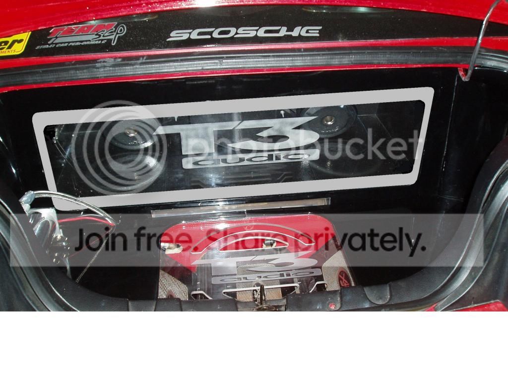

trunk area finished except for putting in push pins on plastic rear piece
I took night pictures with the leds turned on, but they just aren't clear enough to show, will take more night pictures once I figure out how to get them to show clear.

I'm going to tape up and paint plexiglass just like original design which was in vinyl

Yes, far as mounting the other compressor I have the same amount of space for it. I'll have to make a mounting stand like I did on the drivers side,but I see no problem with mounting the 2nd compressor when i get it.On the 1st compressor I had to purchase longer bolts to mount it,I then screwed the bolts into the mounting bracket,mounted the bracket,then the black cover went on,I then experimented by putting small springs over the bolts before placing compressor and bolting it down. That didn't work to good,since when compressor is on the vibration from it loosens the nuts completely,causing the nuts to come completely off.I'm going to try one more idea and if that doesn't work,then I'll purchase the isolation kit.I think my next idea will work,I'll post results when done.
