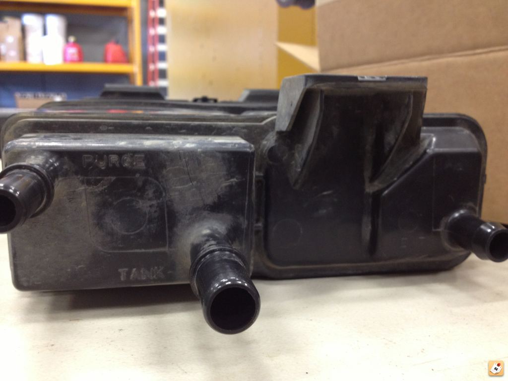

I replaced the evap vent under the hood and the solenoid at the canister and still no change.
kahmann
Jul 9, 2009
713
Sacramento
My canister looks a lot different from the one in the first post.

My problems were, at first I would smell gas really bad at times, and then started to get a rough idle here and there or a brief rough spot after cranking it after it got hot. My biggest problem was, after the small problems started occurring That I mentioned above ,would be after I would fuel up!! whether I had problems filling the tank or not, when I got through fueling up, and went to crank, It would just spin and spin, like it was flooded to death. I guess it actually was, because all I could smell was raw gas, and it would run rough for a few minutes. I would go through the same thing every time I fueled up.
here was mine, Billy
