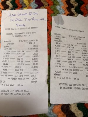

Here is a picture of the time slips, I’m 8351. The right ticket was with 3.31 gears, and a bama 93 tune in august weather(I wasn’t even getting into 4th gear with those gears in the 1/4). The left ticket is with 3.73 gears, lito E85 tune.

The 3.73 gears are forcing you to shift into 4th gear before the 1/4 mile trap and you're thus losing trap speed. With the 3.31 you could hang on to 3rd gear and gain more speed.
Your 60' of 1.727 does point to you having very good traction off the line. As I see it, you just need better air.
Have you run your car on the dyno? What's your rev limiter set at? 6500rpm maybe?

What rpm are you shifting and crossing the line?
What size rear tire?

I’m shifting at about 6,000 and I’m crossing the line at about 5,500-5,600. The rear tire size is 28x11.50x15. The car has 4.11 gears in the rear but with that tire size the overall ratio is 3.73.

I have not had it on a dyno yet but the rev limiter is set at 6,600

Post the real rear in the future, not the effective ratio, better for people to comment. Are u sure they are 4.11 and not 4.10?
You’re shifting too low IMO and not using the RPM to your advantage
I’d think a shorter tire would help or a taller tire so u can avoid 4th gear, though I don’t have my spread sheet to calculate what size would make sense

I will do that in the future, I’m positive they are 4.11 I counted the teeth before I had them installed. What rpm would you recommend shifting and launching at? Not trying to blow the motor yet

odd, didn’t realize anyone made 4.11s for the 8.8
I’d shift at 6500
your launch is fine at 4000, but there’s at least a tenth in your 60’

1. You're shifting way too early. Try shifting at 6500rpm instead.
2. You have 4.10 gears and with 28" tires, your gearing in 3rd is 15.4mph/1000rpm (6600rpm = 101mph), which means you'd need to shift into 4th to complete the 1/4 mile no matter what.
3. You might be better off using 26" tires instead. If you have enough traction, your 60' time will be quicker, and you can go much deeper into 4th gear by the end of the 1/4 mile. Fourth would be geared at 18.9mph/1000rpm and you could hit the trap at 5700-5800rpm.

I’ll try shifting at 6,500 and see what happens, I’ll also probably give some 26 inch tires a try once these wear out. I should probably install a crossover pipe to help with the lower rpm torque lol

Water is already under the bridge now but you may have been better off crossing the line in 3rd with 3.31s or going with 4.30 gears if you wanted to use 4th. 3.73s are an awkward gear for a 110mph car. And it should all be done with 26" tires.

Are your downpipes separate all the way to the mufflers? An X-pipe crossover would definitely help scavenge exhaust gases at medium/higher rpm and equalize gas flow between the two cylinder banks.
Agree. Same goes for 3.55s to a lesser extent.
