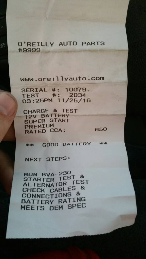

If your battery shows 12.0V your battery is dead.
A charged battery should show 12.6V
12.5V=85%, 12.3V=50%, 12.2V=35%
Fyrestang
Nov 23, 2016
38
Sent from my SAMSUNG-SM-N910A using Tapatalk

Maybe the good people at oreilly can help you figure it out. A good battery puts out 13.2v minimum.
Good luck!
Fyrestang
Nov 23, 2016
38
Eh. They just called ford. They said the battery outputs about 12v when not in car, but about a volt or two higher while it is in the car. Ford said they believe it's the security system. Just a big headache it is
