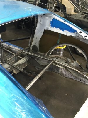

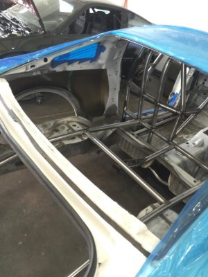

updated progress pics

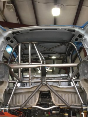

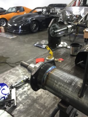

more pics

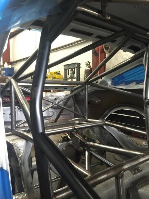

More progress
More progress getting close

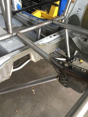

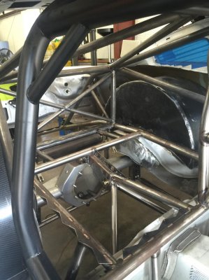

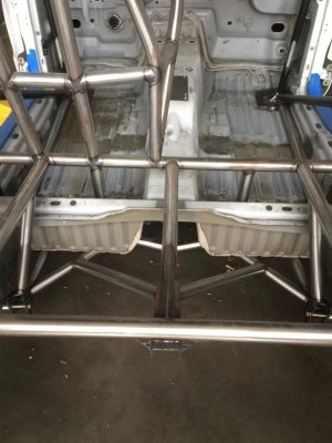

Pentalab
Mar 5, 2013
5,217
1,104

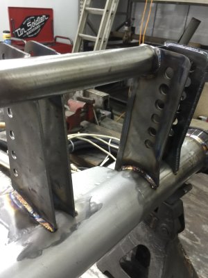

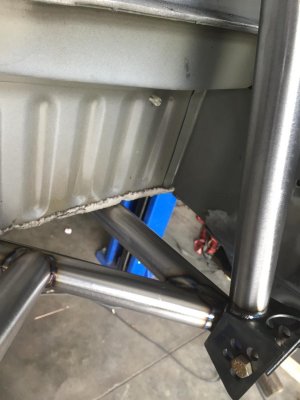

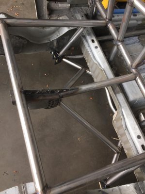

How much weight does that cage add to the car ? It looks like aprx 1 5/8" OD tubing used. Is it CM..or DOM..and what wall thickness? That's a lot of precision cutting and welding. It's also the real deal.
Studly
May 12, 2016
44
VA United States
This cage is 25.3 it is CM not one piece of DOM. all Tig Welded. I do not know the exact amount of weight it will add. but rather have the weight and be safe than not have it, just make more HP if i need it

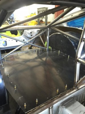

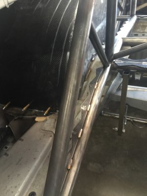

Studly
May 12, 2016
44
VA United States

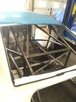

also i am replacing the stock wheel wells with Carbon Fiber and the back will be all carbon fiber so this will save weight from the additional bars

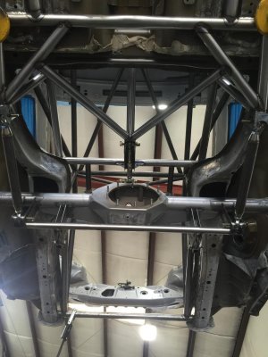

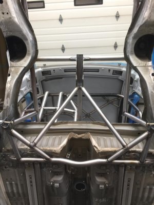

travelers
Apr 6, 2007
3,028
79
Eastern Pa
Progress is a good thing, also looking good. I was wondering why a 3 link over a 4 link. I know you plan is some speed with a funny car cage.

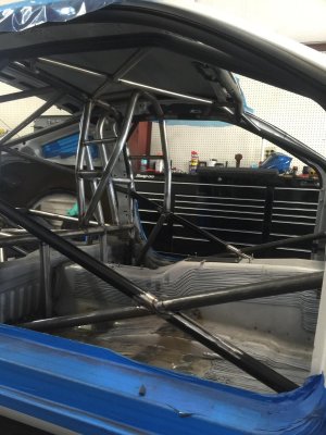

Working on getting carbon and panels made then to paint for the roll cage and underside of the car

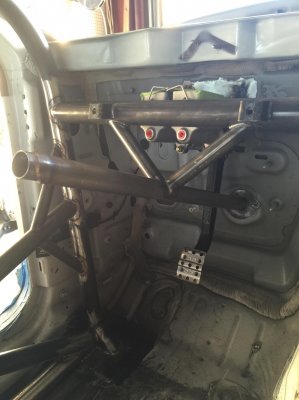

Carbon updates and master cylinder
