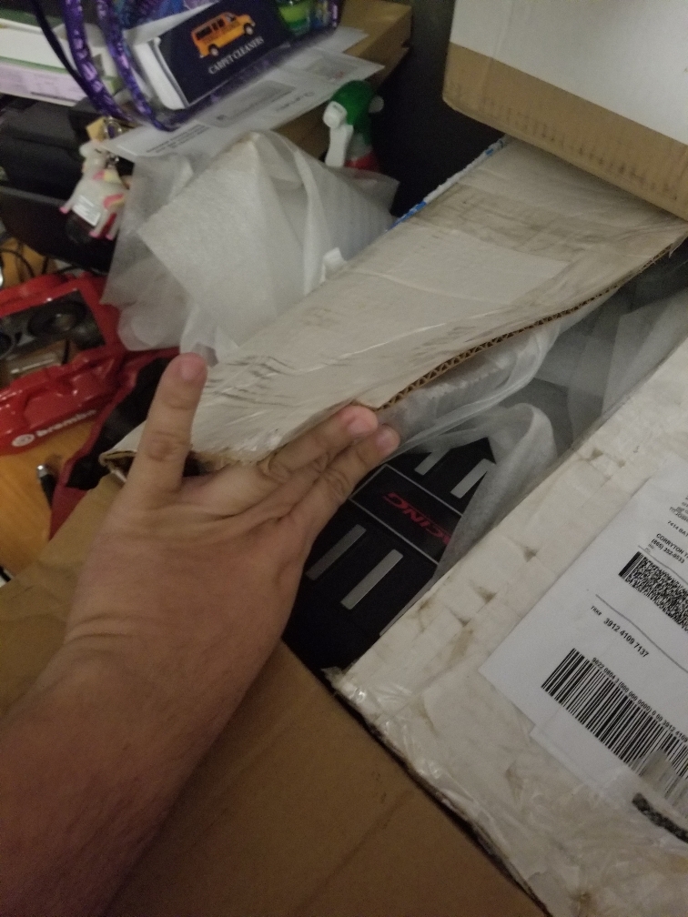

Jan 1, 2020
295
77
That would be the cobra jet intake. The boss does look cool though. I went back and forth on the boss or the 2018.
I had the 18. Sold it and fixing to go boss....
