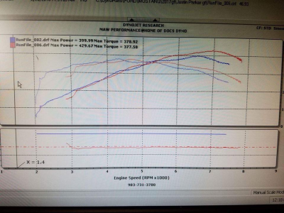

All of the performance gain is from 5500rpm upwards, with the biggest gain from 6500-7500rpm, and this allows you to raise the rev limiter from 7000rpm to 7500rpm. Below 6500rpm, the torque curves of the gen 1 and the gen 3 intake manifold trade blows so there's essentially no real gain in peak TQ, though the TQ peak is raised from 4250 to 4600rpm. Expect a ~15-20rwhp gain in peak HP with the peak raised from 6500 to 7000rpm.
Keep in mind that you'll need to disable the IMRCs on the gen 3 manifold and get a revised tune.

I didn't really notice much of a difference in the car when I did the swap. Like the graph Dino shared, it's all gained way up in the rpm's, so you'll likely not notice any difference just driving it around town. I ported my own and made my own imrc lockouts.
