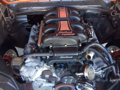

In for updates. I also found a crazy deal for a full E-Force set-up with GT500 HE (all for $2000 local pick-up) that I have "installed" on my 65 Falcon. It is just sitting on the engine for now to test hood clearance and all is good. Strange to hear a report of it being loud, I hope it is, but all reports I have heard are that the E-Force is so quiet that you cannot even tell it is there.
