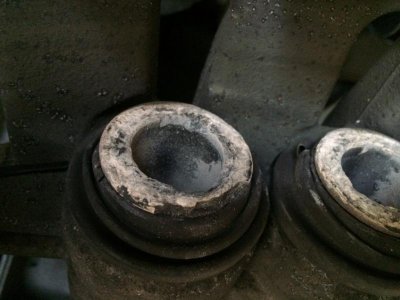

My uneven wear (presumably due to spread as it got worse over time) happened after using DTC-70s for 2-3 events. Between that and my OE pistons crumbling, I'd argue the opposite of your theory is true. :)
We nuked the phenolic pistons on our Crown Vic LeMons car in similar fashion.
I do think that your symptoms are related.
The only way I can envision caliper spreading happening is from a combination of high caliper temperatures in the 'bridge' region and "excessive" caliper piston forces. High caliper forces are what you end up with if you're operating out there on the down-slope of pad mu vs temperature - IOW some fade is already present. Basically, you're stomping on the pedal harder to make up for lost mu.
On crumbling . . . with a high enough ▲T across the friction material, sustained for a big enough portion of the time, even a material with low thermal conductivity will let heat through it. Once it does get through the pad material and the low-thermal-resistance steel backing into these particular pistons, there's a lot of resistance to it flowing any further (air gaps between the pistons and their bores won't transfer much heat). I would certainly expect a pretty large, nonlinear ▲T within the pistons themselves between the pad contact surface and the fluid surface - probably intentional for the brakes of most street-intended cars even though it puts the pistons themselves at risk under extreme braking events that are repeated at short time intervals. Before I got downsized out and eventually took retirement, thermal transient and 2-D heat transfer analyses was part of my day job, and I don't think I've forgotten all of the concepts quite yet.
I'll risk a guess that with pads of more or less similar composition but lower temperature rating you'd be fading the pads.
