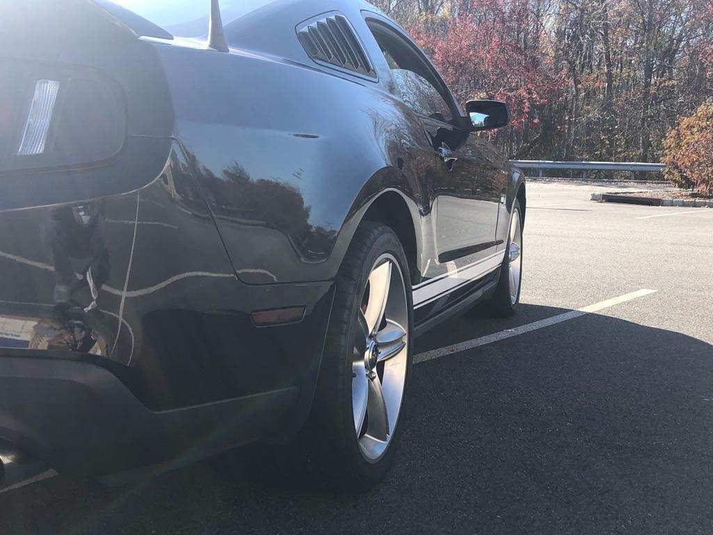

Tired of the “tucked in” look on the back wheels, so put on 25mm coyote spacers. I really like the stock 19’s, and I can’t go any wider with the tires (255/40), so this was my option. Looked weird at first, but it’s growing on me.

Looks good with the spacers. After you put a few hundred miles on it, take the rear wheels off and re-torque the nuts on the spacers and then the lug nuts.
Now it’s time to lower it!

Yup. Probably take me a month or two to get that mileage, then I’ll check again.
I know it’ll look/handle better if I lower it, but I’ve got a pretty bad lower back and I don’t want to ruin the relatively decent ride I have now.
I did add konis, a boss 302 sway bar, a rear shock bar, and tubular control arms and panhard rod. Plus it’s a Trackpack car, so it handles good enough for me.
