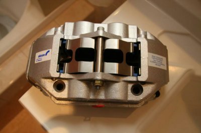

I don't think these calipers have the pad guide plates like the OEM calipers do. I experienced a popping, creaking from one of the thin plates wearing down and the pad having to push across the divot. It did it standing still or moving and stopped once new guide plates were installed.
Here is the bottom of the caliper if it helps you at all
Sent from my SM-G925V using Tapatalk
Sky Render
Stig's Retarded Cousin
Feb 24, 2011
9,463
357
NW of Baltimore, MD
Yeah...
OEM Brembo Caliper:
The pads have holes that those two pins slide through, keeping them consistently "flat" against the rotor. I wonder if this is your problem? How old are your pads?

Maybe 2 years old. And yeah I thought of that but the way they sit inside are very tight virtually no walking around.
