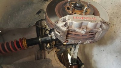

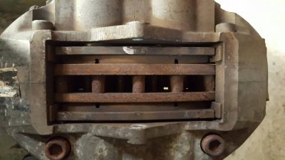

Well went over it with a fine tooth comb. Everything is tight and rebleed the whole damn car with a air compressor vacuum bleeder.
In the second picture is how centered it is. A little off but pad wear is consistent it seems. I may shim it out a bit more for my own personal like but that's about it...from last night to this morning it hasn't done it but that doesn't mean squat haha
Sent from my SM-G925V using Tapatalk

Make sure the mounts are not cracked and the bolts are not broken and tight. :party52:
Triple checked that. All good and snug. Oddly enough since I rebled the brakes yesterday no pop....but I haven't driven very far either....

Ok well....happened 3 times....randomly....all either when I hit the pedal or a second or 2 after I hit the pedal...I'm thinking sticking piston?
2Fass240us
Nov 6, 2011
324
At this point it may be worth exploring a rebuild. How much are seal kits for those calipers?
