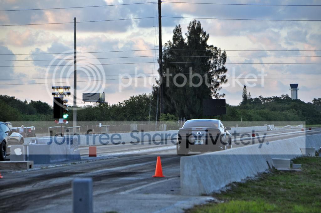

Well, that wasn't posted... Lol
Not good. I didn't take into account my 3" exhaust. So I was running 11psi and not the 15.5 as advertised by kb. So a new pulley is needed. The meth isn't running yet since its not tuned for its use. Top that off with bad track prep and getting use to these tires.
I'll just say it wasn't good. 7.368 and 103 was the best time and mph. So it's slower than before right now. Also probably about 50-80hp slower.

That's actually not bad for 11lbs. Mine would make about 400hp on 11lbs. lol.

Yeah, I figure I will buy the 20.5lb or 22lb pulley.
Temped to get the 24lb... Hehe

I think one of each sounds reasonable. lol.
I have 3. One for 17lbs on pump. One for 20lbs on pump/100 mix. And one for 23lbs on pure 100 octane. Once I upgrade the blower (and the rods) I plan to have one for 26lbs or more and C16 or E85.
