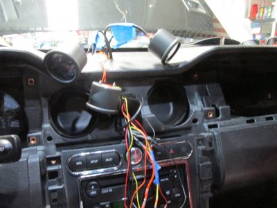

I installed on my 07 GT, used Glowshift gauges, easy enough to put gauge pod in, I used GlowShift gauges since they are electrical easier to run wires, I did drill hole in dash to route wires and you will have to remove the facia to make the install easier. Overall very happy with product and install. Glowshift offers the ability to change colors and good option at price point. I was able to use one power source for all the gauges and was able to utilize sender for oil pressure from Glowshift. I also used the solder connectors that use heat gun to connect all electrical wires as you want to do this only once. Hope this helps. dash.jpg Gauge wiring 1.JPG

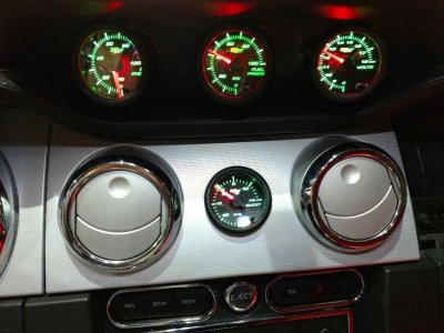

yes i've fitted the autometer one. Its not the best quality as it doesn't fit flat on both sides and the wires are a right pain in the arse to fit through between the vent and dash top. Also the stick on mount with 2 studs in was to short so i made my own with longer studs in. I'll take a photo when i get chance.
I think it looks ok though, and im happy i fitted it.
