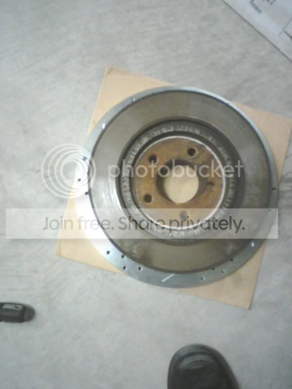

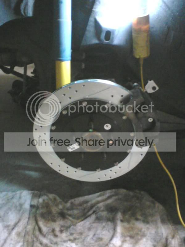

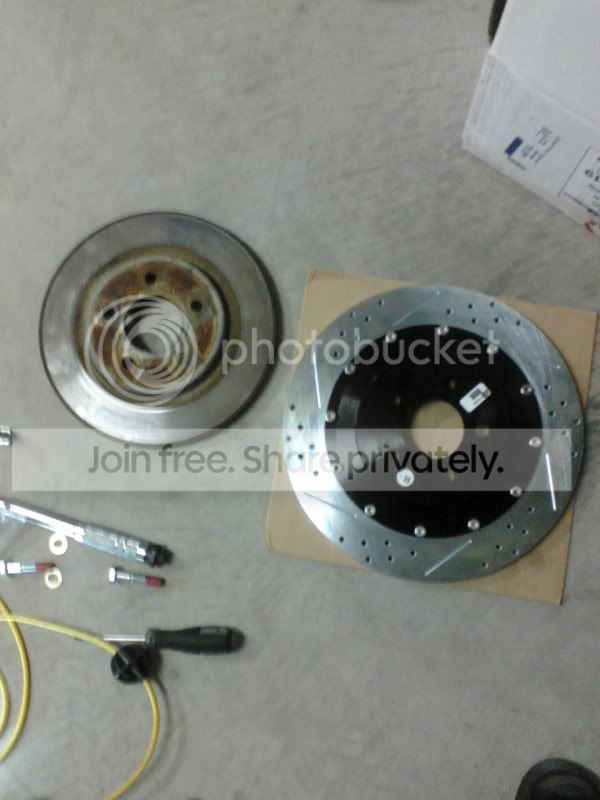

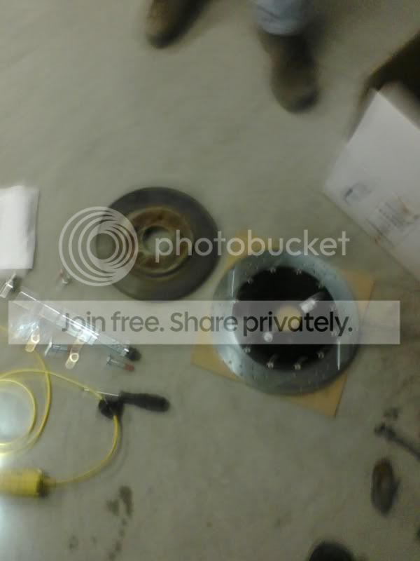

Alright I purchased a set of 14" rear bear brake rotors and the caliper brackets. Ive looked on line even pulled the instructions per Bear, and yet I feel like I am missing something
Its a pretty simple install yet I am lost or confused.
Per Bear I retain my stock caliper, and anti moan bracket, and simply install the new bear bracket with the ingraved numbers facing inward...there kit supplies two brackets, four bolts, and two rotors..

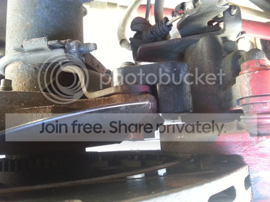

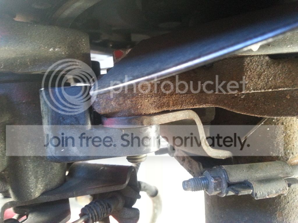

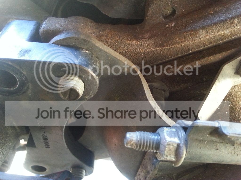

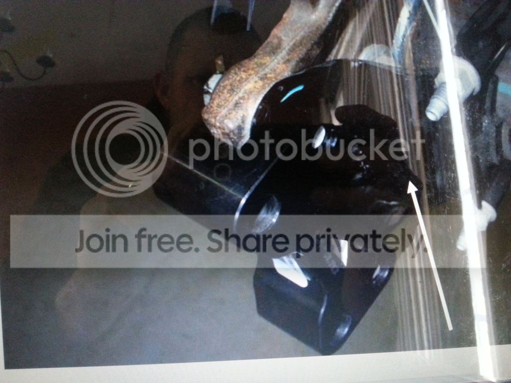

When I installed it, it appears that my caliper is too far away from the bracket mount see pictures
Its almost as if the anti moan bracket would give me back the correct spacing, but its not supposed to be moved correct?
Or maybe I just need to turn my caliper in and will thst make up the room?
Im looking for anything I am missing or guidance. Thanks Rob

Is the rotor all the way up against the hub? You know it moves.

OP, not trying to de-rail your thread or bring it down on ya at all, but why are you using an aftermarket rear brake setup that retains the stock caliper? All these adapters are just another point of failure if shit hits the fan. The '13 GT500 rear brakes are the easiest and best quality conversion you can do for your rear brakes if you're not looking for a rear caliper upgrade. OEM 05-10 S197's use a 11.8" rear rotor, the '13 GT500 uses a 13.8" rotor. The caliper is still a single piston floating caliper. For the swap, it requires the removal of your axels to remove the caliper bracket from the axel tube assembly, and swap out for the GT500 brackets. Reinstall axels and from there it's a regular brake job, and you'll need to use a set of '11-14 GT rear calipers or the '13-'14 GT500 calipers. The GT calipers are more readily available but often enough the '13 GT500 rears come as a complete setup. I paid a little over $300 for the complete swap. It's a true OEM fit 'n finish.
Again, not saying what you're doing is a negative, but when I look at the pictures of how they are trying to shortcut and extend the early S197 OEM caliper bracket, it just doesn't sit well in my gut. I'm sure it works if they sell it, just can't say I would want all that bolted up to my calipers.
The only thing I can suggest in relation to the issue is to check with Baer to see if you are using the correct equipment for what you have. If Baer specifies that their adapter uses *specifically* the 05-10 S197 caliper or if you are supposed to use a different model caliper. That's all I can think of if you are having dimension problems.

Next up was instaling the baer rotor caliper adaptor. it mounts on the spindle and moves the caliper out to fit the larger rotor. The directions from baer call for using the supplied bolts to mount the adaptor, which are longer. and using the factory bolts to mount the caliper, but the stock bolts were too short for the adaptor/caliper. So we ended up installing the adaptor on the spindle with the stock caliper bolts and used the supplied longer bolts to mount the caliper to the adaptor.
Side by side of stock vs baer rotor
Reinstalled the caliper with the Hawk HPS pads on the baer rotor

I got it all worked out last night, once I compressed the piston in and tightened everything back up it all fit as it should, it was just at first glance when I adapted the Baer bracket it seemed it was going to be out of alignment from where it should be, but it wasn't, little pre panic on my part.
