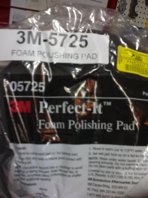

The best thing to use is 3M products for scratch/swirl removal. you will need a variable speed buffer and you must know the correct pad to use with the correct compound and use the proper technique. Some tips that go along way in swirl removal is to tape all edges and mask of any area that could get some compound sling. always work in a small area 2x2 at most. for black see the pictures ofr some of the best tools of the trade.
