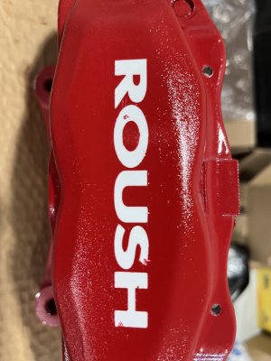

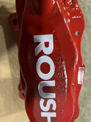

Got my new calipers painted but the decals didn’t stick. Never had this problem, maybe bad decals or I screwed up lol. Put them one after last coat of painted and put 3 coats of clear over them. Started peeling up then falling off…

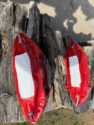

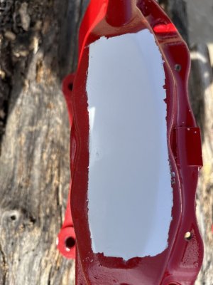

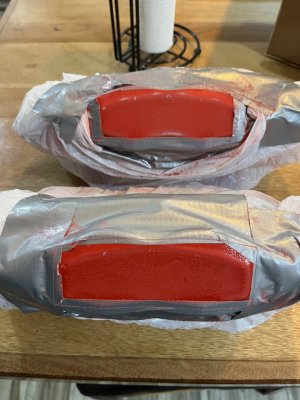

Id like to get your/everyone’s opinion on what to do from here. I’m going to try and do what you suggested and use the decals as a stencil. I taped off the area to paint white (shouldn’t have used duct tape but it’s all I could get to stick) and painted. Peeled the tape off and the edges are really rough. Plan to sand edges, re-tape further bad with masking tape hopefully, apply decals and shoot red if it gets warm enough today!! Totally wrong approach, other ideas…?

Why mask the edges for the logo color at all? Just make sure the area the logo will be in is fully covered with white. Any overspray outside that area will get covered with red anyway.

Just so I don’t have to disassemble them again really. Not hard I guess, could do it that way. Still have the plugs I used for the holes. The calipers have been clear coated already, didn’t really want to spray over that with red. Was just gonna mask, spray red, unmask, then clear coat again. Don’t really care if the clear gets on the hardware except the rubber. Hmmmm may just disassemble. Couldn’t do anything today, winds blowing to hard

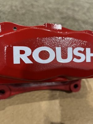

Well…using the decals as stencils didn’t turn out real well for me I guess, not to bad though! The red started getting into the white, prob needed to let it dry alittle more. Used a razor blade to get under sticker, then peeled up with tweezers! Figure I’ll run them & when I do paint I’ll pull them back off and get them powder coated. Got frustrated & impatient and ended up dropping one in dirt (still tacky) b4 clearcoat.
