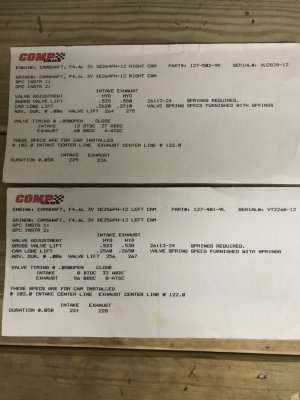

Speaking of cams. I’ve been running Comp Cams 127350 and eyeballing their 127450. If you are running the 127450 in your blown 3 valve would you please list the valve timing from the cam card?

Just curious why are you switch from the 350's to 450's? I have been running the 350's for years, even running them with the turbo

I don’t have a problem with the 127350 cams and I bet they make great turbo cams. I am opening the engine for inspection and to install a billet crank gear so this would be an opportunity to change cams if I was going too. I’d like to see the intake and exhaust valve timing of the 127450 for comparison. The 127450 could offer a couple hundred rpm higher range and a little more power.

Top card is 127500. The 450 has 4 deg more exhaust duration and 1 more degree lobe separation. These are close and should give you rough idea, I doubt anyone has 450 card to send you. Hope this helps. And the 450 has .005 more exhaust lift
Bottom card is 127400 so disregard

The 127450's have 16.5 degrees of overlap @0.050" lift, the 350's have -2 degrees @0.050" lift. The
127350's close the exhaust valve sooner so will have better low RPM torque, the 127450's close the intake later but use the exhaust to scavenge the intake charge to make more peak torque. The extra intake duration and lift will aid in high RPM power.
With long tubes, no worries about the overlap as there is going to be almost no backpressure in the exhaust and with a P/D blower, reversion is almost impossible.
I personally would pick the 127450 but I am not sure I'd bother with replacing the 127350's that are already there.
