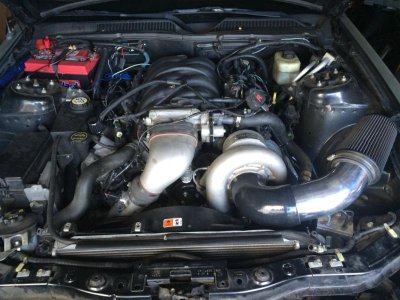

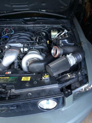

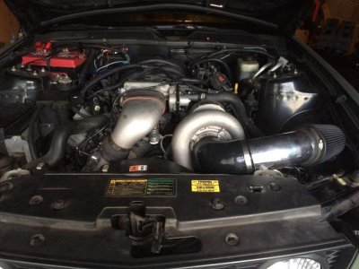

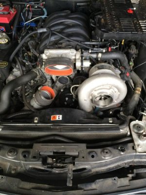

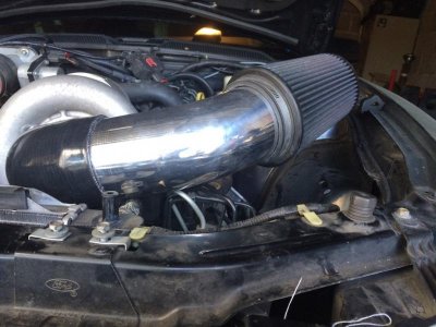

Had to ditch the draw through setup and converted to blow thru.... I have a question regarding the diy power pipe, I can seem to get to fit in there perfectly- any sugestions? U can see in the last pic how it's raised to high to where I can't shut the hood! Seems to be hitting

Rotated the pipe in the coupler? I had to do the same on my CAI on my 6.7 Super duty.

Yupp! That's what I did. Rotate the elbow coupler up a bit and rotate the 45-degree pipe downward a bit. I'm still waiting on my Race Port BOV from TurboSmart though.

What did you use to plug the two 1" ports that remain after removing the stock bpv?

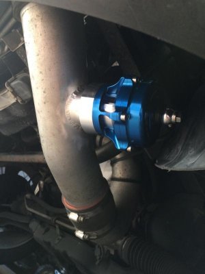

In my setup, one was plugged by a welder when he mounted my PMAS flange. The other is currently being used for a 25mm Kompact BOV (which I think is too small).
I just bought a 52mm Race Port BOV from TurboSmart. I still have fluttering but I think I need the softer spring in it.

I'm running the 2 psi spring in mine, I believe it's the green
