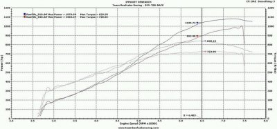

And terry we want more power out of it...Put that bad boy on C16....lol
But makes me wonder where did power come from. The blower/cams/heads/intake.
How much moreboost then before?

That is about tapped out for a Ysi. I don't see much more power without a bigger blower.

How do you figure. Over e80.
from the famous tapatalk
There really isn't much difference in the power that e70 (full winter blend) can support vs full summer blend e85. I found this from testing on my car. I never did any race gas testing, but have seen reports from others showing a power increase over C16 with E85. Q16 might pick up a bit. you lose the advantage of the cooling effects of E85 on the air fuel charge so as the system heat soaks, e85 can support closer to peak power longer than Q16.
